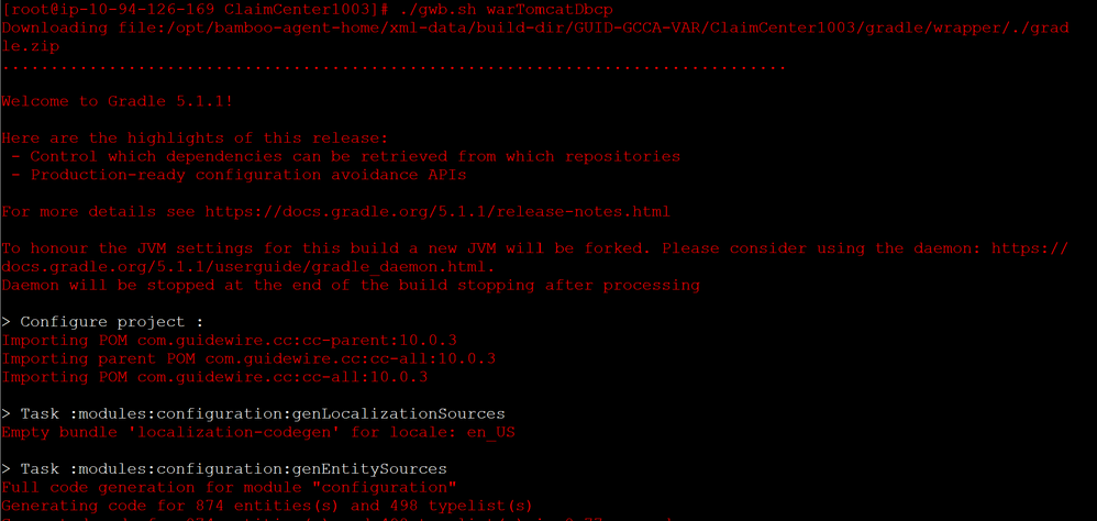

Java is set in all the bamboo servers though not working in many server through the console but when I triggered the build from command Line it is working fine.
The build is working in some servers giving me the output as I needed:
javac 1.8.0_161 build 05-Jun-2020 13:18:01 Downloading file:/opt/bamboo-agent-home/xml-data/build-dir/GUID-GCCA-VAR/ClaimCenter1003/gradle/wrapper/./gradle.zip build 05-Jun-2020 13:18:02 ................................................................................. build 05-Jun-2020 13:18:04 build 05-Jun-2020 13:18:04 Welcome to Gradle 5.1.1! build 05-Jun-2020 13:18:04 build 05-Jun-2020 13:18:04 Here are the highlights of this release: build 05-Jun-2020 13:18:04 - Control which dependencies can be retrieved from which repositories build 05-Jun-2020 13:18:04 - Production-ready configuration avoidance APIs
Build going through when did in CLI
