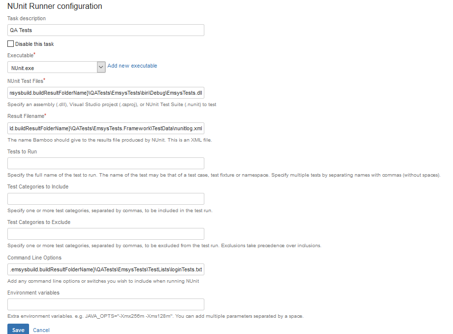

For QA, we run some website interface tests (Telerik), which are run through NUnit. Up until now, we have been running them manually through VS/Console and just waiting for it to run, but I have been looking to automate it. I saw that Bamboo had an NUnit test runner/parser task, so I set it up with the tests we run, defined the tests, and defined a results file. The set up is below.

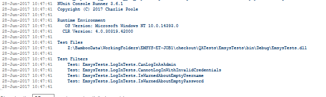

However, when running the test, it gets to a point in the logs where it initializes the test, acknowledges the test list and everything, but then just hangs indefinitely with no logs after after. I have kept it running for around 25 minutes sometimes before having to manually cancelling it. I am not sure where it is getting hung since there is no log files or anything after the test initializes, so I imagine it is running into an error even just opening a browsers. I can log into the account it uses and run the tests manually through console, but when trying to automate it, it just doesn't want to run, with no log of what is wrong.
