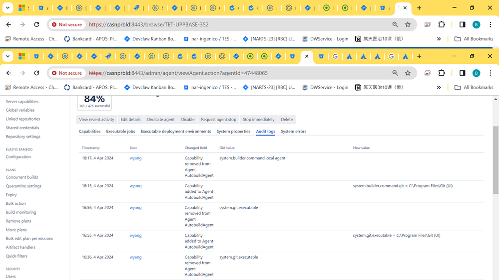

The previous GIT was installed in D drive by someone, just recently, one of our big team member try to add capabilities into one agent. At the beginning did not see this GIT already listed in the agent, also checked it in Control Panel, still not seen since it is in D drive. Therefore by accident, a old version of GIT installed again in C drive, later I saw it is installed in D drive therefore uninstall the GIT on C drive. However, because of this our bamboo plan is always complaining this below errors and no agent to run, the bamboo build failed to launch...
Is this because of the local agent removed by accident as below:
18:17, 4 Apr 2024   system.builder.command.local agent
Bamboo_Git_Authentication_Issue.pngIt is sort of disaster to us. Is anyone having such experience and have a solution to solve this issue?
The above seems to a manually defined a capability which you seems to have removed it from Bamboo GUI, you can add this capability again if it's required by your Jobs to run
