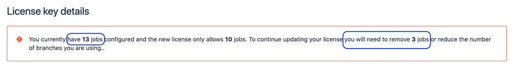

Here is an example:
  • Installed Bamboo with and evaluation license, in which does not impose the limit in jobs or agents.
  • Created plans and branches, reaching the number of 13 jobs
  • Attempted on updating the license to a Starter License under BAMBOO_BASE_URL/admin/updateLicense.action resulting on
  • disabled all plans using bulk action BAMBOO_BASE_URL/admin/viewAvailableBulkAction.action (re-attempted on applying Started License, same notification as in screenshot)
  • disabled all jobs (re-attempted on applying Started License, same notification as in screenshot)
  • deleted 1 job (re-attempted on applying Started License, same notification as in screenshot, HOWEVER, number of jobs decreased by 1)
