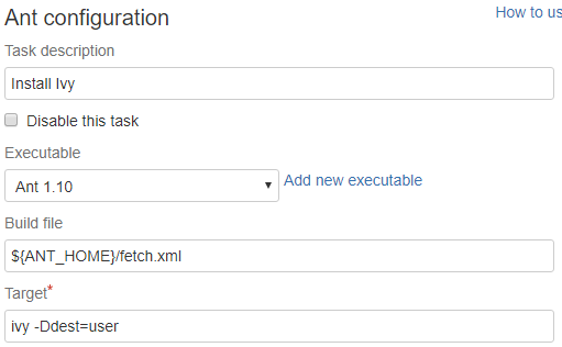

I'm trying to use Ant along with Ivy, and am trying to use Ant to do a user-install of ivy. This command works locally (and on the default Ubuntu elastic bamboo image when run as a Script task):
ant -f ${ANT_HOME}/fetch.xml -Ddest=user ivy
But when I try using the Ant build task configured like so:
I keep getting this error in my logs:
Buildfile: ${ANT_HOME}/fetch.xml does not exist!

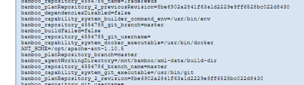

But I see in the blue log box for the Ant task that ANT_HOME is defined:
I've verified that the fetch.xml file does exist in /opt/apache-ant-1.10.5, so what am I doing wrong?

Usually, the task body does not resolve variables from the terminal. The variable ANT_HOME does not exist in the Bamboo application variable context. You should be able to find a variable called bamboo_capability_system_builder_ant_<name> where <name>is the label you gave to your ANT capability when creating it. You can find the right variable in your build logs.
Your test works on a script task because the variable you add there is evaluated on the terminal and therefore the variable is available.

Thanks! I was able to use:
${bamboo.capability.system.builder.ant.Ant 1.10}/fetch.xml
 It took a little tinkering to get the naming right, but that worked.
