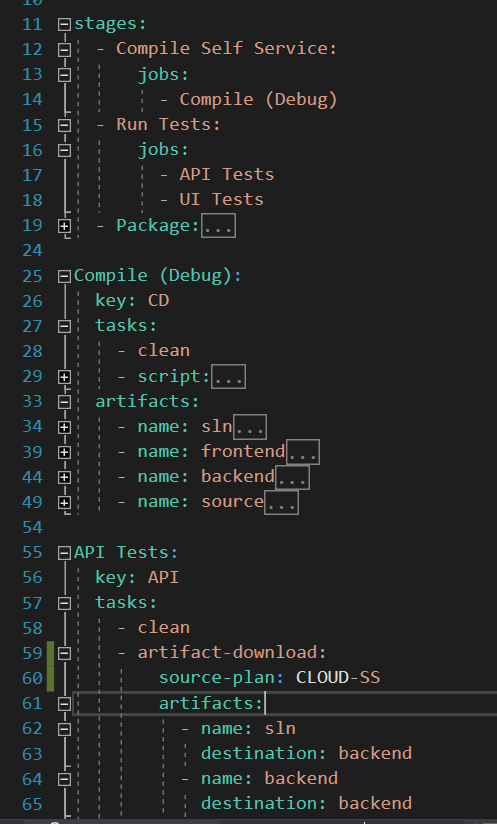

I have a multi stage YAML spec. 4 artifacts are defind in job 1 of stage 1 - Compile (Debug).
In stage 2 job one I want to pull down 2 of the 4 artifacts, sln and backend.
This YAML parses fine and the plan is created.

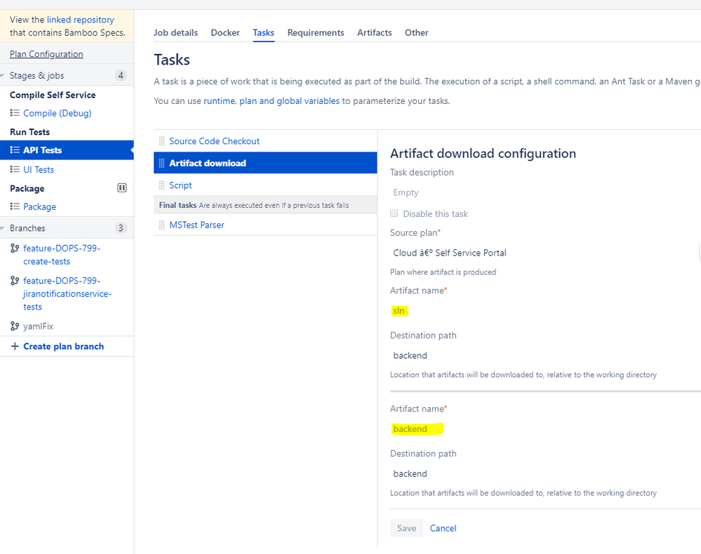

You can see the artifact download task correctly defining the 2 artifacts I specifiedimage.png

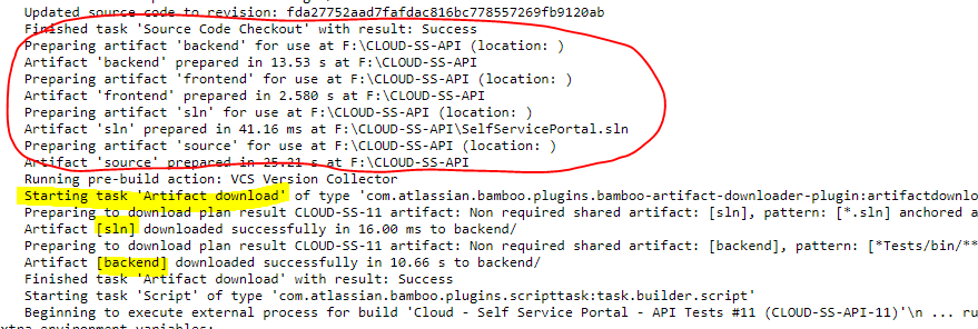

However, all artifacts are registered to be downloaded at the job level. Both frontend and source are incorrectly defined here.
At run time, you can see bamboo processing both the job artifacts and the task.
How do you stop a job from registering the artifacts if using the artifact-download task?
