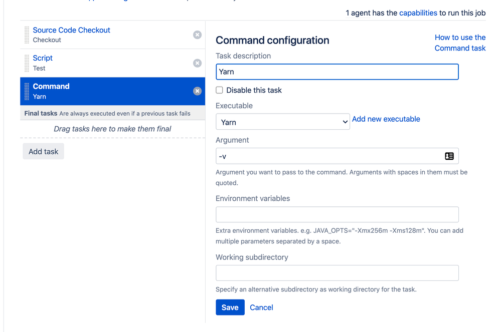

When i login into the server and on command prompt type yarn -v or npm -v or node -v, it returns result and i have added successfully location in add capabilities key and value section. But when i run basic command like yarn -v from bamboo build job it doesn't works.
Location is correct and its 64bit os
basically the error you can see is:

Hi @Abhishek Saharan ,
This is mostly because the PATH variable inside the bamboo task does not include yarn and node. Add "echo $PATH" path command into your bamboo task and compare the result with the one when you login to the server.
Hello @Mehmet A _Bloompeak_
you are right,
echo path command "echo %Path%" when i log into the server returns
C:\Python38\Scripts\;C:\Python38\;C:\Program Files (x86)\Common Files\Oracle\Java\javapath;C:\Windows\system32;C:\Windows;C:\Windows\System32\Wbem;C:\Windows\System32\WindowsPowerShell\v1.0\;C:\Windows\System32\OpenSSH\;C:\Program Files\Amazon\cfn-bootstrap\;C:\Program Files\nodejs\;C:\ProgramData\chocolatey\bin;C:\Program Files (x86)\bin\;C:\Program Files (x86)\Yarn\bin\;C:\Users\bamboo\AppData\Local\Microsoft\WindowsApps;
and echo path command from bamboo task return this
C:\Users\bamboo\bamboo-agent-home\xml-data\build-dir\MWC-CIWIN-JOB1>echo C:\Users\bamboo\AppData\Local\Microsoft\WindowsApps; |
but while adding capabilities to agent, i added path to these tools. Picture attached.
Any suggestion is appreciated, thank you very much for the response and guiding in right direction.
Now i added the path in windows bamboo user environment variable and from bamboo task it return correct result
08-Oct-2020 05:50:55 | C:\Users\bamboo\bamboo-agent-home\xml-data\build-dir\MWC-CIWIN-JOB1>echo hi; echo C:\Program Files (x86)\Yarn\bin\;C:\Program Files (x86)\bin\;C:\Program Files\nodejs\;C:\Users\bamboo\AppData\Local\Microsoft\WindowsApps;; |
08-Oct-2020 05:50:55 | hi; echo C:\Program Files (x86)\Yarn\bin\;C:\Program Files (x86)\bin\;C:\Program Files\nodejs\;C:\Users\bamboo\AppData\Local\Microsoft\WindowsApps;; |
08-Oct-2020 05:50:55 | |
08-Oct-2020 05:50:55 | C:\Users\bamboo\bamboo-agent-home\xml-data\build-dir\MWC-CIWIN-JOB1>yarn -v |
08-Oct-2020 05:50:56 | 1.22.5 |
but as in the message above this message you see i added the capability(screenshot) and when i run this task(screenshot attached). I get the same error. How to get yarn then?
"Failing task since return code of [C:\Program Files (x86)\Yarn\bin\yarn -v] was -1 while expected 0"
Is it cause i am using command task ?? and these tasks might not work for windows cause script tasks returns fine and all the results.
