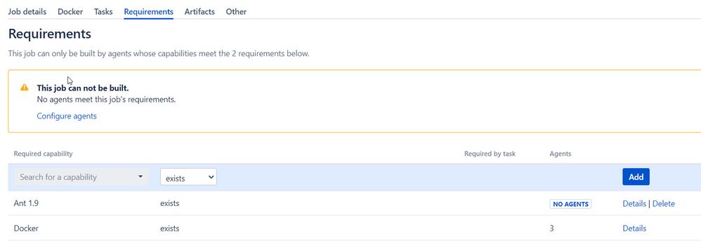

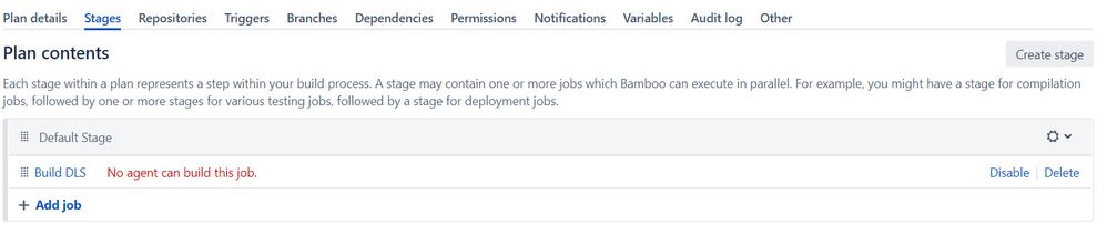

New to Bamboo. I'm seeing message "no agents". See the attached screenshots. Any thoughts to fix the issue?
Hi Reneesh,
Welcome to Atlassian Community.
We understand that you are getting the "No Agent to build this job" error on your plan.
As per your Job requirements screenshot, we could see that none of your agents has Ant 1.9 installed to run your job.
A requirement specifies a capability that an agent must have for it to build that job or task.
Please refer: Configuring a job's requirements and Agents and capabilities for more details.
