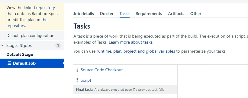

I have a repo that has bamboo spec defined, and when the plan is created it is adding a checkout source code task that i have not defined in the spec. How do i stop this; as i dont need the job to check out any code, just run a script?
version: 2
plan:
  project-key: TEST
  key: XTEST
stages:
- Default Stage:
    jobs:
    - Default Job
Default Job:
  key: JOB1
  tasks:
  - script:
      interpreter: WINDOWS_POWER_SHELL
      scripts:
        . write-host "hello"

Add line below to your specs
repositories: []
Dave Attard
February 5, 2023
Confirmed, thank you
