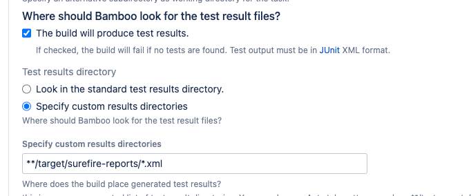

As I see you are using Maven, is your build producing test files. This should be in the xml format and should be present inside the build directory where Bamboo can read it, are you able to confirm if the xml files exist?
By default Maven will look into the default location, but you can modify it to look into a specific directory where the xml files are present
You can read more about it at https://confluence.atlassian.com/bamboo/configuring-a-test-task-289277052.html , there is also an option to use the test parser task to separately parse these test files if you which locations they are generated within the build directory.

Hello Pramodh,
This means your build is not producing any Test XML, which Bamboo will read to understand if it contains any test cases or if the XML is produced it is not in right format.
Can you check your code to validate if it produces valid test XML files which contains test cases which Bamboo can parse?
Can you see the location of these XML's in your build directory and make sure maven task is configured correctly to read those.

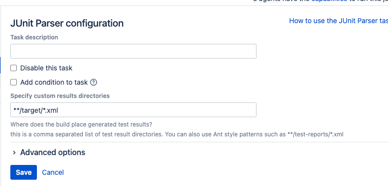

For the first problem, let's try another way for Bamboo to Parse these test xml files
Can you try to use Junit test case parser task in your plan after the Maven build task and see if Bamboo is able to read these files, see below
In the logs you'll see the information that Bamboo is looking for these files in the directory mentioned.
simple 31-Jul-2023 10:43:29 Finished task 'Maven 3.x' with result: Success simple 31-Jul-2023 10:43:29 Starting task 'JUnit Parser' of type 'com.atlassian.bamboo.plugins.testresultparser:task.testresultparser.junit' simple 31-Jul-2023 10:43:29 Parsing test results under /var/atlassian/application-data/bamboo/local-working-dir/622593/SCRIP-TIC-JOB1...
There you'll see the message whether it is successful or not.
If Bamboo is able to parse the test results, but still the test case count is zero, it means that xml is not in right format for Bamboo to understand.
Please refer this page which provides one of the xml in correct format which Bamboo can read
https://confluence.atlassian.com/bamboo/junit-parsing-in-bamboo-289277357.html

Hello Pramodh,
At this point It looks like Bamboo is reading the XML file, but not able to parse it, hence you are seeing the exception >
Failing task since test cases were expected but none were found.
Can you compare your XML file with the one provided in https://confluence.atlassian.com/bamboo/junit-parsing-in-bamboo-289277357.html and see if the format matches.
You can also looks for errors in the below files in the agent to see if there is any error thrown while processing the test file like missing tags etc ?
1. <bamboo-agent-home>logs>atlassian-bamboo.log
2. <bamboo-agent-home>atlassian-bamboo-agent.log
If you are still not able to understand the reason, I would suggest you to raise a ticket with Atlassian support with a valid SEN id, so that it can be looked further.
