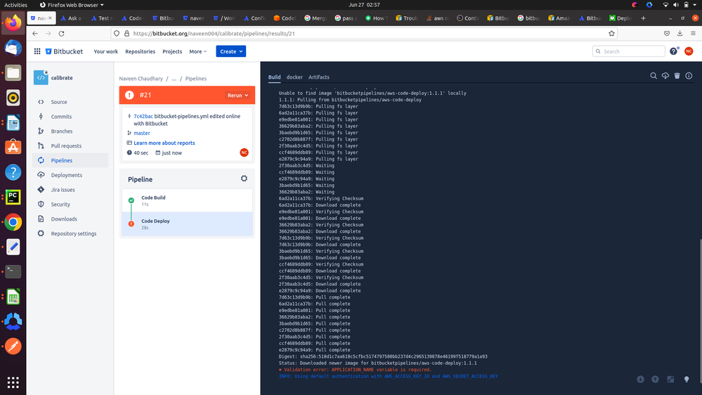

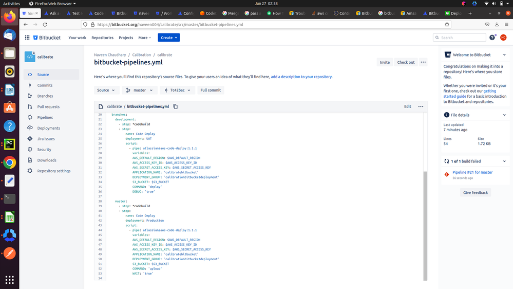

I have a pipeline to ec2 and using aws ec2 codedeploy pipe and i have set all variables.Bur still I am getting error.
For reference check screenshot:Screenshot from 2022-06-27 02-57-06.pngScreenshot from 2022-06-27 02-58-08.png

@Naveen Chaudhary  hi . Thanks for your question.
You have problems with linting:
You have this:
script:
- pipe: atlassian/aws-code-deploy:1.1.1
variables:
APPLICATION_NAME: 'my-application'
but should be this:
script:
variables:
Check this guide for more info.
Regards, Igor.
Patrik S
June 28, 2022
Hello @Naveen Chaudhary ,
It seems like you pipe if failing in the validation of the APPLICATION_NAME variable, that is a required variable in aws-code-deploy pipe
Although from your screenshot you are already defining this variable, to make sure there's no typo in your bitbucket-pipelines.yml file, I would suggest copy/paste the variable from below, replacing it in your yml and try running again :
If that still does not work, could you please share the full logs of the pipe run? I'm especially interested in the beginning of the pipe logs, where it describes all the variables passed from the build container to the pipe's container.
Also, could you please confirm if you have any environment variable at the workspace/repository/deployment level with the same name as APPLICATION_NAME ?
Thank you, @Naveen Chaudhary

@Patrik SAs you have suggested i have copy and paste the APPLICATION_NAME variable,but still it is not working.
Please check logs below.
Logs:-

INFO: Using default authentication with AWS_ACCESS_KEY_ID and AWS_SECRET_ACCESS_KEY
✖ Validation error: APPLICATION_NAME variable is required.
