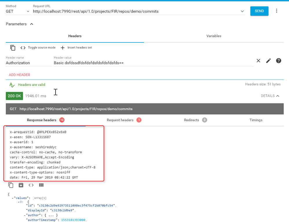

We are trying to Access the Bitbucket Rest services directly via web browser(Browser is making call to bit bucket service  directly no back end service interaction)
We are getting below exception :
XMLHttpRequest at 'http://hostA:7990/rest/api/1.0/projects/FIR/repos/demo/commits'
from origin 'https://hostA:8080'
has been blocked by CORS policy: Response to preflight request doesn't pass access control check:
No 'Access-Control-Allow-Origin' header is present on the requested resource.
also above information and this information https://jira.atlassian.com/browse/BSERV-10589
is contradicting
Also CORS header is not present in response, please .

Thank you for sending over your response errors and the screenshots of your attempt. Something between your communication with the Bitbucket instance and your call is triggering CORS. It might something network or device related which is causing this.
With this said, you will need to include CORS headers within your API calls for them to respond successfully. Could we please attempt an API call with the CORS headers?

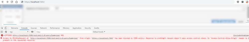

i am trying something like below.
I have a web application(Demp App) which is running on port 7443 and it has some UI and from UI we are making call as shown below
i.e, it will not hit the Demo App, but it tries to connect bibucket server and it gives CORS
xhr.get("http://localhost:7990/rest/api/1.0/users/UserId, {
headers: {
"X-Atlassian-Token": "no-check",
"Access-Control-Allow-Origins" : "*",
"Access-Control-Allow-Methods":"OPTIONS",
"Authorization": "Bearer "+accessToken
Please refer below screenshot
Thanks in Advance.
