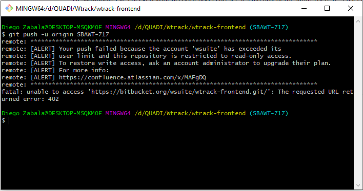

Diego Alberto Zabala Betancur January 15, 2020
Hi Edwin, I was experiencing the same error because the suite administrator in Bitbucket was changing the type of payment plan to free without informing the rest of the team.
Check it.

Diego Alberto Zabala Betancur October 8, 2019
Hi Ana,
Thank you very much for being so active in trying to solve this problem. At the moment I have the same problem, but the administrator of the bitbucket account has already eliminated the surplus of users (more than 5) and I still cannot push the repository. I wanted to know if the change takes some time to be reflected.

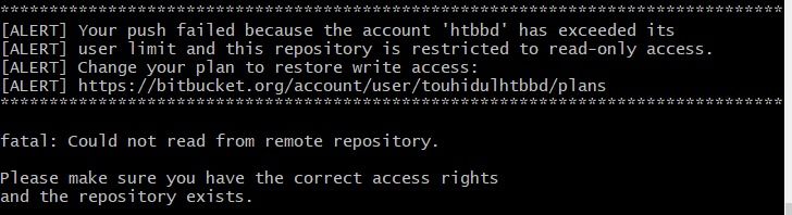

Md. Touhidul Hasan
June 25, 2022
@Ana Retamal We are using the Standard package but:

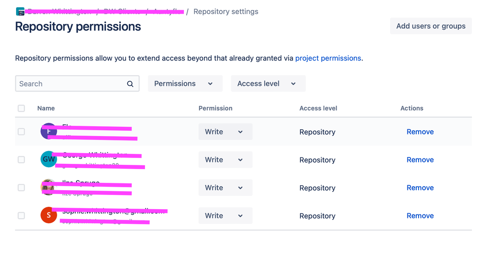

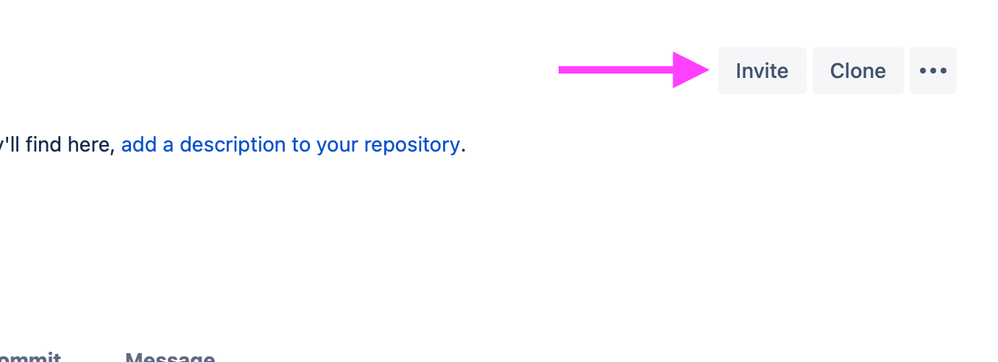

darrenwh June 1, 2024
The way to get around this is to go to your repository page like https://bitbucket.org/{account name}/{reproname}/src/master then click on the invite button to the left of the clone button, this will then take you to the correct page to add users that's limited to 5.

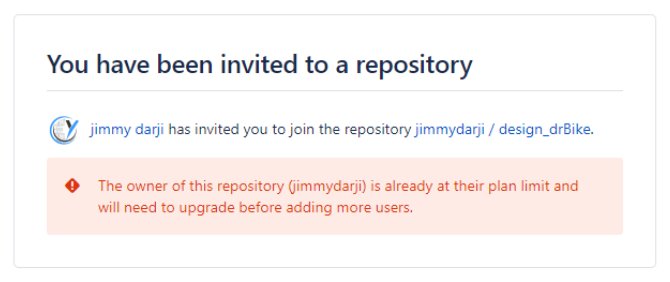

jimmy darji
February 7, 2023
I Have Same Problem
will you please take a look in to it please

Having the same issue with 5 users only. I was able to extend the invite to the last user for one repository, but for second repo, it is showing the following error:
"The owner of this repository is already at their plan limit and will need to upgrade before adding more users."

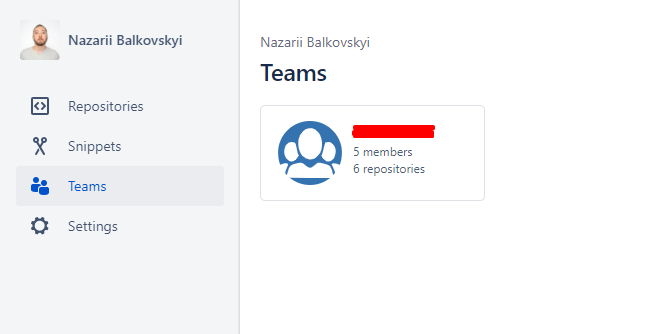

Nazarii Balkovskyi
February 4, 2020
I have the same issue. There are 5 users in our account.
I'm not the owner. We upgraded the plan but still getting the same issue.
Can you please take a look at why it's happening?

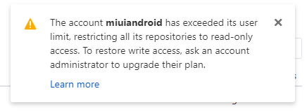

ingbrzy
June 7, 2019
Hello @Ana Retamal
I have same issue even we have just 5 users in the team..
could you check "miuiandroid" account please..?
thank you
ingbrzy
June 7, 2019
OK solved.. we were 6 there.. sorry..
