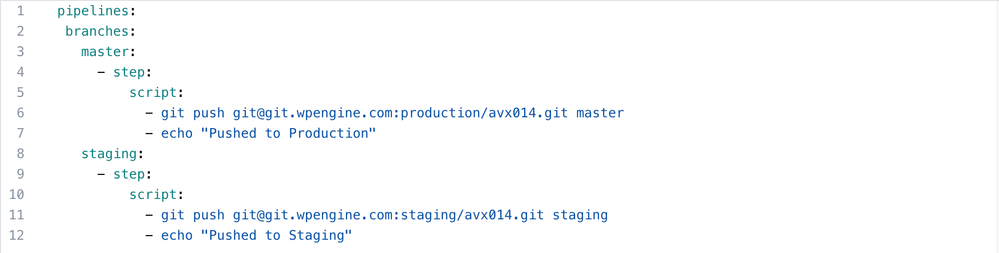

This was up and running yesterday but today when I merged my updates from staging to master and checked pipeline tab, it's not working anymore. Anyone know what might cause the issue?
