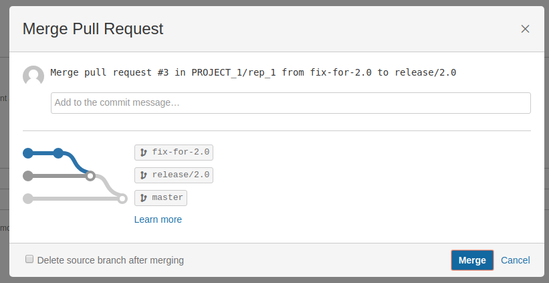

Julius Davies [bit-booster.com]
January 31, 2018
I'm releasing a new enhancement to my paid add-on tonight (Bit-Booster - Rebase Squash Amend), and part of this work required me to thoroughly experiment with automatic merging yesterday and today.
So here's the thing:
Merges into "develop" will never cascade.
Only merges into release branches or production branches will cascade up.
If you want to see a full cascade based on your setup, try this:
git checkout release/2.0
touch a.txt
git add a.txt
git commit -m 'to see cascade'
git push origin HEAD:refs/heads/fix-for-2.0
And then create a pull-request to merge this new "fix-for-2.0" branch into "release/2.0".   Right away on the pull-request merge dialog you'll see that it wants to do the cascade:
Some additional notes:
- Auto-merge only happens for changes that arrive via PR.  Direct pushes never trigger auto-merge.
- If there's already an open PR for one of the steps of the cascade, then that step will be skipped.  e.g., if "release/2.0 --> master" was already sitting in an open PR, then the auto-merge will defer to that.
