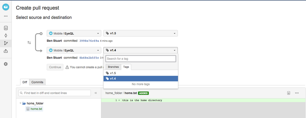

You can tag commits that you wish to diff and then create a pull request and selecting tags instead of branches.

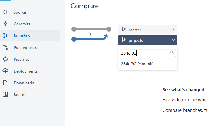

Go to compare and past commit id into search field:
