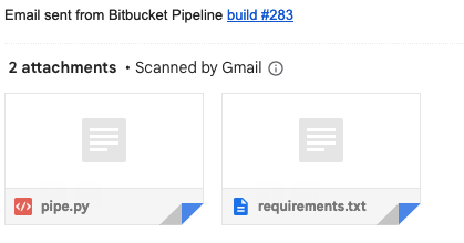

@pascal_schroeer hi. I used this pipe by myself and see the two files.Screenshot 2024-03-01 at 17.41.41.png
Regards, Igor
