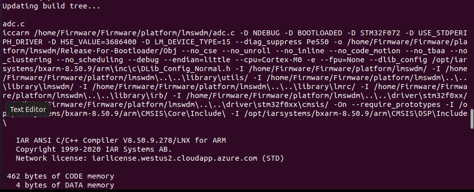

I'm currently working on setting up pipelines for an embedded c project.  I've got a working pipeline set up using GCC already but now must set up a similar pipeline using the linux version of iar build tools (bxarm)
I've got a custom docker image set up with all the required software and licenses installed, and a .yml file to load the docker image, and run the iarbuild command. Where I'm getting stuck is that while I can successfully run the intended command in my docker container locally, if I try running the same command in bitbucket my build hangs forever until I kill it.
Can anybody think of a reason why a script would work successfully in a local docker container but not on bitbucket's environment?  I'm rather stumped.
See the output from bitbucket pipeline.  It almost seems like the command is missing a return key or is waiting on something to continue. I've uploaded a screenshot of what happens when I run the same command on my local docker container.
iarbuild Firmware/platform/lmswdm/lmsw105.ewp -build "Release-For-Bootloader" -log all
IAR Command Line Build Utility V8.4.11.7092/LNX
Copyright 2002-2020 IAR Systems AB.
Building configuration: lmsw105 - Release-For-Bootloader
Updating build tree...
0 file(s) deleted.
adc.c
iccarm /opt/atlassian/pipelines/agent/build/Firmware/platform/lmswdm/adc.c -D NDEBUG -D BOOTLOADED -D STM32F072 -D USE_STDPERIPH_DRIVER -D HSE_VALUE=3686400 -D LM_DEVICE_TYPE=15 --diag_suppress Pe550 -o /opt/atlassian/pipelines/agent/build/Firmware/platform/lmswdm/Release-For-Bootloader/Obj --no_cse --no_unroll --no_inline --no_code_motion --no_tbaa --no_clustering --no_scheduling --debug --endian=little --cpu=Cortex-M0 -e --fpu=None --dlib_config /opt/iarsystems/bxarm-8.50.9/arm\inc\c\DLib_Config_Normal.h -I /opt/atlassian/pipelines/agent/build/Firmware/platform/lmswdm/ -I /opt/atlassian/pipelines/agent/build/Firmware/platform/lmswdm\..\..\library\utils/ -I /opt/atlassian/pipelines/agent/build/Firmware/platform/lmswdm\..\..\library\lmswdm/ -I /opt/atlassian/pipelines/agent/build/Firmware/platform/lmswdm\..\..\library\lmrc/ -I /opt/atlassian/pipelines/agent/build/Firmware/platform/lmswdm\..\..\library\irb/ -I /opt/atlassian/pipelines/agent/build/Firmware/platform/lmswdm\..\..\driver\stm32f0xx/ -I /opt/atlassian/pipelines/agent/build/Firmware/platform/lmswdm\..\..\driver\stm32f0xx\cmsis/ -On --require_prototypes -I /opt/iarsystems/bxarm-8.50.9/arm\CMSIS\Core\Include\ -I /opt/iarsystems/bxarm-8.50.9/arm\CMSIS\DSP\Include\

Theodora Boudale
January 21, 2022
Hi @Tyler Jones,
I'm not sure why this issue occurs, we would need to check the build logs to investigate.
Does this repo belong to a workspace on the free plan or a paid plan?
If the repo belongs to a workspace on a paid billing plan, you can create a ticket with the support team to investigate this. You can create a ticket via https://support.atlassian.com/contact/, in "What can we help you with" select "Technical issues and bugs" and then Bitbucket Cloud as product. You can copy-paste the content of your community post in the ticket, and also make sure you provide the URL of the build.
If the repo belongs to a workspace on the free plan, please feel free to let me know and I can create the support ticket for you.
Theodora
