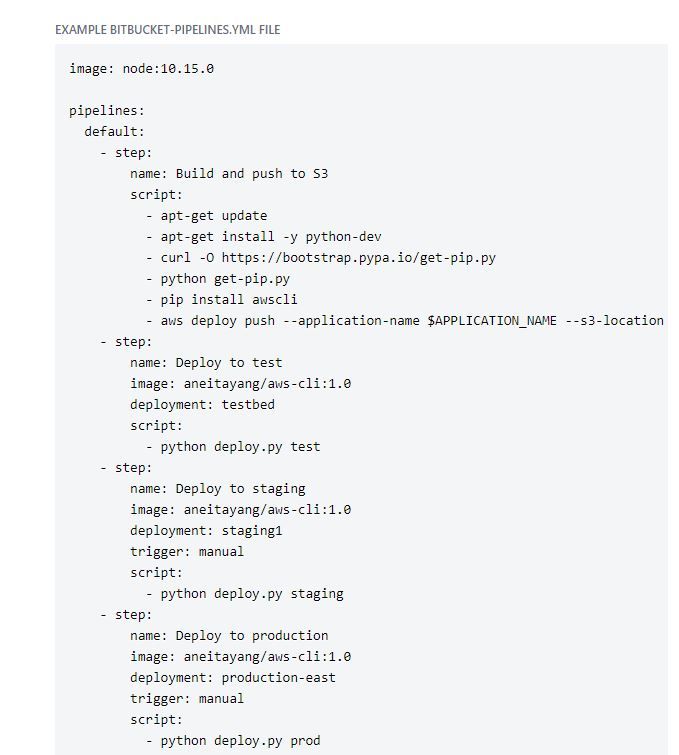

The example in the documentation at this link shows a sample pipelines config file that contains deployments with names other than 'test', 'staging' or 'production':

please check the first paragraph of the documentation link. If you want to use custom names in the bitbucket-pipelines.yml file, you first need to define these values in the Bitbucket settings.  Under Settings / Pipelines/ Environments.
