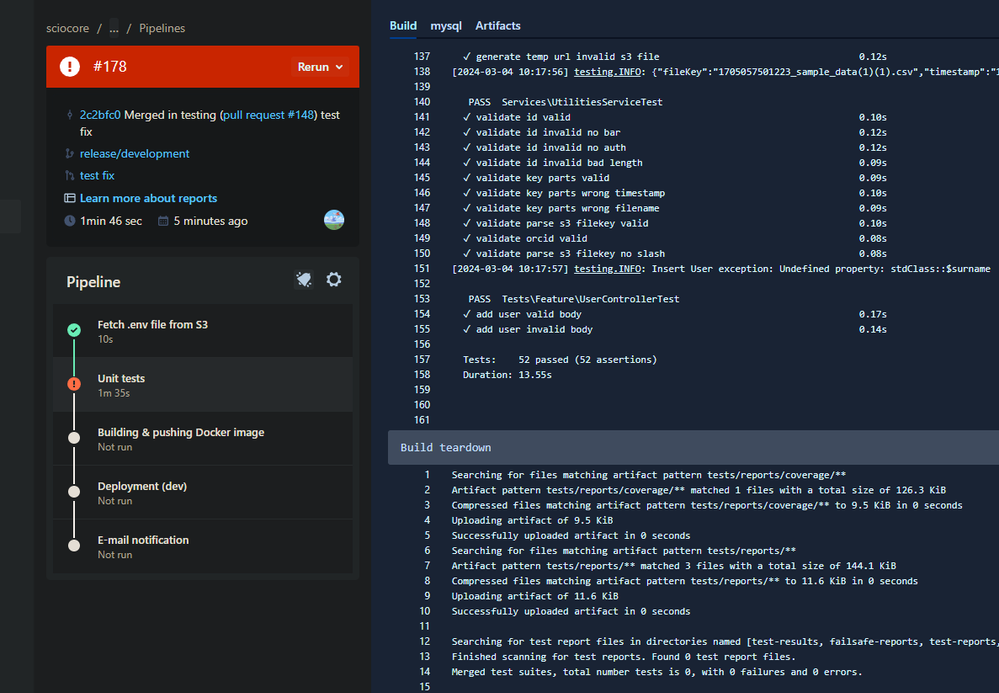

We have configured a pipeline where we ran some unit tests for a PHP Laravel project which includes the below:
- step:
services:
- mysql
image: webdevops/php-nginx:8.2
script:
- composer install --no-interaction --optimize-autoloader --ignore-platform-reqs
- pecl install xdebug
- echo "extension=xdebug.so" >> /opt/docker/etc/php/php.ini && echo "zend_extension = xdebug" >> /opt/docker/etc/php/php.ini && echo "xdebug.mode=coverage" >> /opt/docker/etc/php/php.ini
- php artisan test --coverage-clover tests/reports/coverage/coverage.xml --configuration phpunit.xml
artifacts:
- tests/reports/coverage/**
The unit tests are running successfully, so the pipeline should continue to the next step alhtough upon the successfull execution of the tests, the pipeline fails with no any explanation or any insightful log.
The same setup was working until few days ago.
We also tried to manually re-run a previous successful pipeline and the issue occurrs there too.

The way that pipelines identify if a step was successful or not is based on the exit code of the commands being executed. A command that exits with code zero indicates a successful step, while any exit code other than zero will make the step be considered as failed. What may be the case is the command you are executing is returning a non-zero exit code even when the tests are successful, making the pipeline understand it as a failure.
