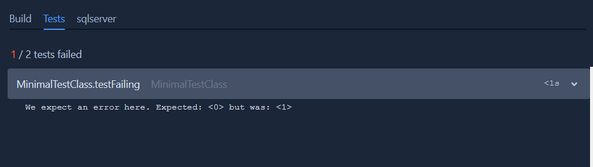

I have a test project that runs tSQLt tests on a separate service running the MSSQL 2017 server image.
The tests run correctly, and the output is in a correct XML format.
But even though one test failed:
The pipeline is still marked successful:
What am I missing here?
Thanks in advance for the help!

A Pipeline is marked as success or failed based on the exit code of all the commands set. So if your command has the exit code 0, we will still mark that as successful. Most tools will return a non-zero exit code when a test fails. Perhaps you can configure your tool to have a different exit code.
The test output shown is read straight from the xUnit XML output. It doesn't influence the final result of the pipeline.
