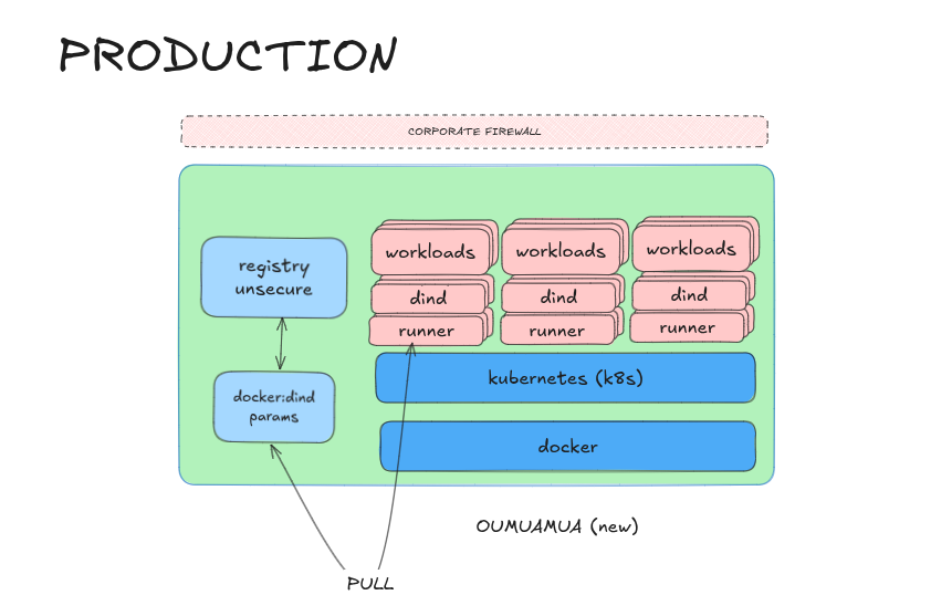

EDIT: Solution Implemented & Remaining Limitation
Thank you all for the input. I wanted to share the solution I eventually implemented and a minor limitation I encountered.
Initial Workaround (Abandoned):
Initially, I managed to work around the direct authentication issue by routing registry access through a proxy server that used IP whitelisting for authorization. While this technically allowed access, it introduced significant delays, making image download times during pipeline execution unacceptably long.
Final Solution (Improved Performance):
Due to the performance issues with the proxy, I opted for a different strategy focused on local access speed:
docker:dind
(Docker-in-Docker) image. The key modification was configuring the Docker daemon inside this DIND image to trust and allow pulling from the local, unsecured registry. This typically involves adding the --insecure-registry <registry-host-ip>:<port>
flag to the DIND daemon's startup parameters.docker:dind
image for the runners it provisions.This setup allows the DIND service within each runner pod to pull images very quickly from the registry located on the same host machine.
Remaining Limitation (Hostname Resolution):
The only drawback with this approach is accessing the local registry from within the DIND container using a hostname. Modifying the /etc/hosts
file inside the docker:dind
container (either during build or runtime) proved problematic. Therefore, any references to the private registry within pipeline steps (e.g., in image:
definitions or docker pull
commands inside scripts) must use the K8s node's IP address and the registry's port (e.g., image: 192.168.1.100:5000/my-image:latest
) instead of a hostname like my-local-registry:5000
Architecture Diagram:
