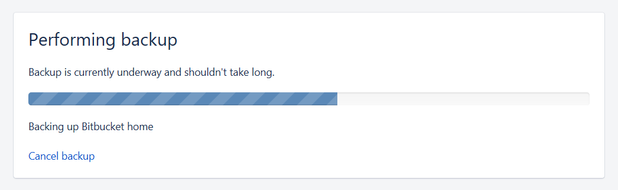

daniele_bernardini February 13, 2019
Sometimes my Bitbucket backup gets stuck showing the progress bar. The actual backup seems to be completed but the progress bar doesn't move. Any suggestion? Thanks.

I think we would need to take a look at the log generated by the backup client or the output of your backup DIY script and correlate that with your atlassian-bitbucket.log. There are some debug logging options that could be helpful as well. It may be easiest to open up a support ticket if you have a valid support license. Does this backup ever complete from the UI? Also, is this for data center?

When it gets stuck it never completes, or more precisely, the progress bar never completes, but we think the actual backup does complete. In these cases we need to force a stop manually.
