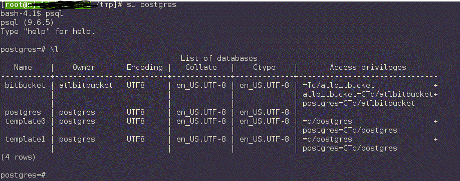

This is what the DB looks like (attached img)
Anyone has a the answer?
