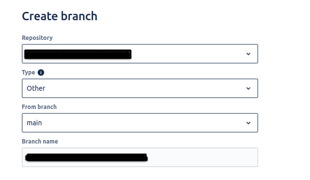

When we enter an existing branch name in the "from branch" field, and if there are fewer than 25 branches that include the search term, I can see the branch I want. However, if there are more than 100 branches and we enter a specific branch name, and that branch appears after the 25th record, then it is not visible in the "from branch" section. The exact match branch should appear at the top. I checked the API call, and the exact match branch is on the 3rd page. When we enter any branch name in the "from branch" section, it only shows the first 25 branches in the dropdown list, even if the exact match branch is not visible on top.
