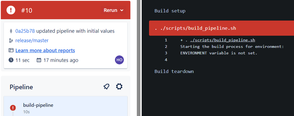

but when I push a commit to test the deployment, the ENVIRONMENT variable returns an error.
ENVIRONMENT variable is not set
I use echo in the script to be able to log the error and $ENVIRONMENT is empty.

Currently the build fails here when I have clearly created the ENVIRONMENT variable:
