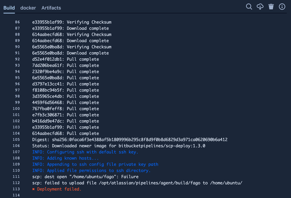

I'm writing a pipeline with scp-deploy and the pipeline is working fine if my executable is not on the server. However if it is already there my pipeline fails. Do I have to remove the file before deploying ?
Pipeline:
Error if the executable is on the server already:

Possibly because /home/ubuntu/fago is read only? Can change the permissions before copying, or `atlassian/ssh-run` and change the permissions remotely only, or use rsync instead?
Yohan Le Bricquer
August 11, 2023
Thanks for replying. I tried with rsync and it's working now whether the executable is on the server or not.
