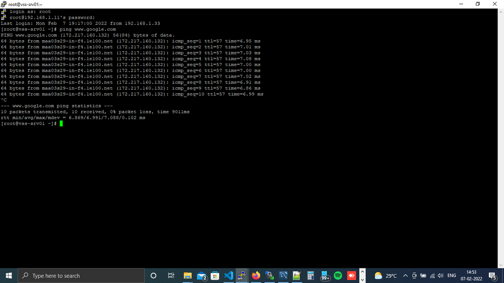

yes, I had the same doubt that it may be an internet issue, to verify I tried ping on google.com, it was pinging, to the reference I attached the screenshot.ping_server.png

Yeah, You can reach the internet, but this is reverse!!
Internet can't reach your machine!!
