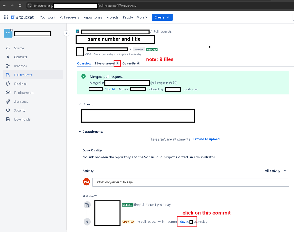

  1. Open the pull request

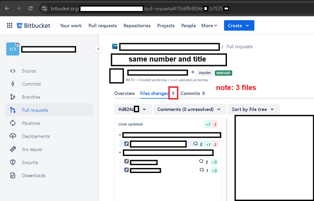

  2. On the overview tab, click on one of the commit hashes
  3. It opens the files-changed tab but with a completely different set of files that do not belong to this PR

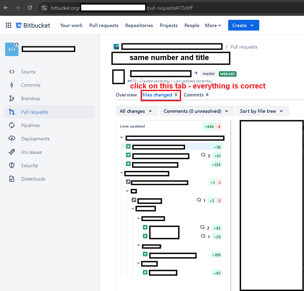

  • If I restart from step 1 and do not do steps 2 & 3, but instead if I navigate to the files-changed tab by clicking on the tab element (id="pull-request-tabs-1") then it loads the correct files for the PR and everything works as it should.
PR overview page:
Incorrect files-changed tab reached from steps 2 & 3:
go back to step 1 and click the files-changed tab:

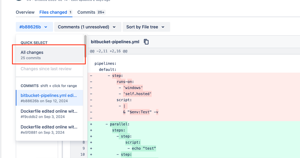

When you click on a commit in the Pull Request Overview tab, the page will redirect you to the Files changed tab and filter the diff to only that single commit. This is the reason why you see less files changed, because the diff in this case is not considering all the commits in the pull request, but that single commit you have clicked.
To view the diff of all the commits, you can click on the dropdown and select All changes, like in the below example :
That dropdown enables you to see the different across individual commits, or a range of commits you select. It also has the option to show All changes, which will make the diff considering all the commits that are part of that pull request.
I hope that helps to clarify!
