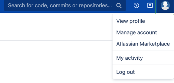

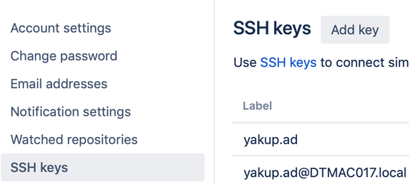

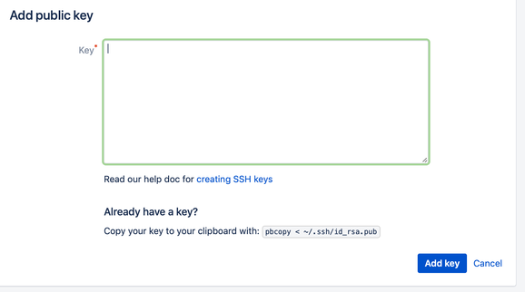

Yakup Ad
July 13, 2019
You need create ssh key!
Steps: Open Terminal
ssh-keygen
pbcopy < ~/.ssh/id_rsa.pub (This command copied clipboard your ssh key)
 1)Go to your stash site. Click Manage Account TabScreen Shot 2019-07-14 at 02.13.36.png2) Click Add key ButtonScreen Shot 2019-07-14 at 02.14.11.png3)Paste (ctrl + v) Key Area -> Click Add key buttonScreen Shot 2019-07-14 at 02.14.18.png
4-> Run your python script
