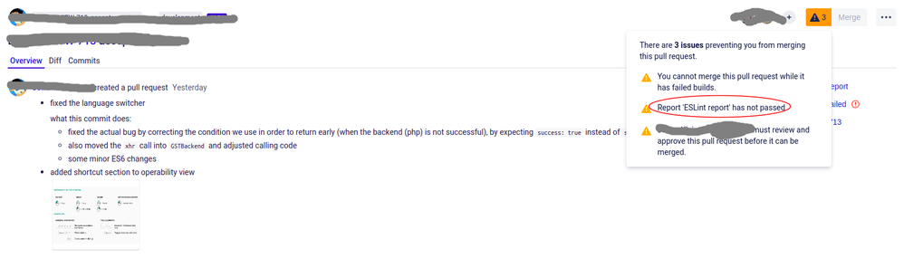

I implemented Code Insights result (ESLint report) as parameter to do merge checking and it shows that I do not have any errors of warnings regarding ESLint report, see picture below:

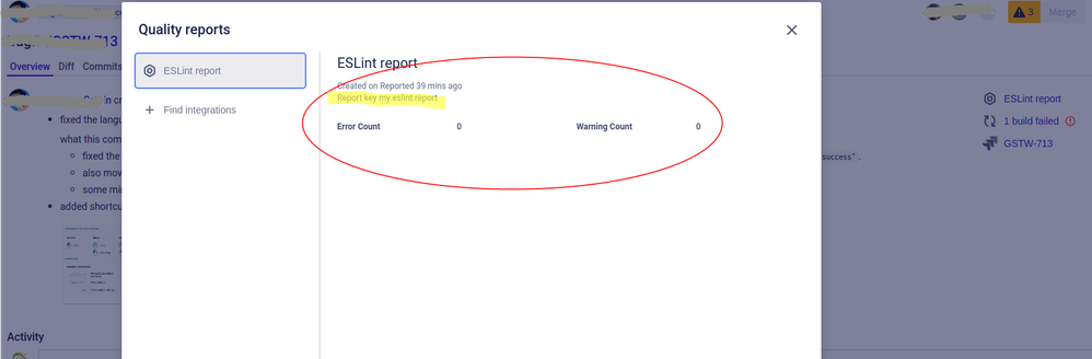

However, it said that one issue prevents me from merging the PR due to 'Report 'ESLint report' has not passed' which exactly strange since I do not have any error or so (Please neglect the other issues preventing me from merging the PR):

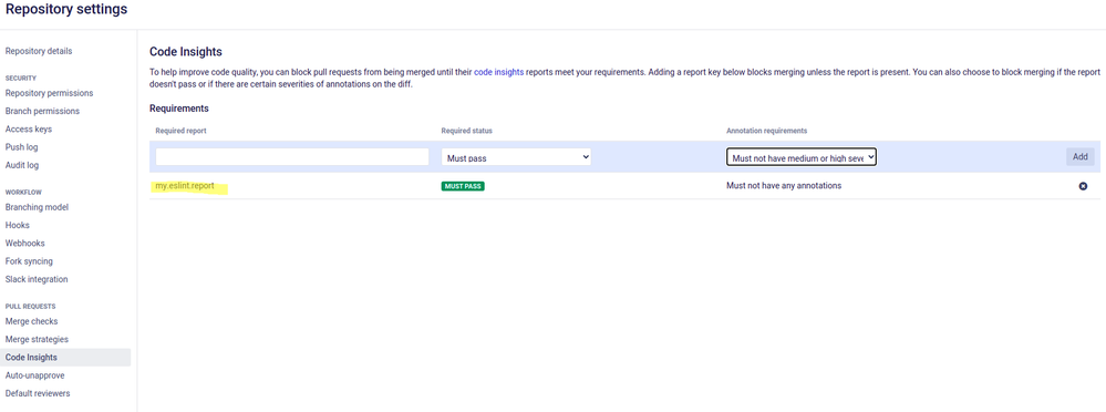

Moreover, I did put the correct report key on Project settings > Code Insights console such that:

It seems that your code insight post doesn't have a 'result' field on the create report request. Otherwise it would show a "Passed" lozenge in the sidebar of that dialog.

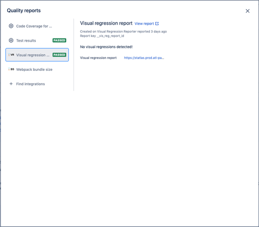

For example, it would look like this:
