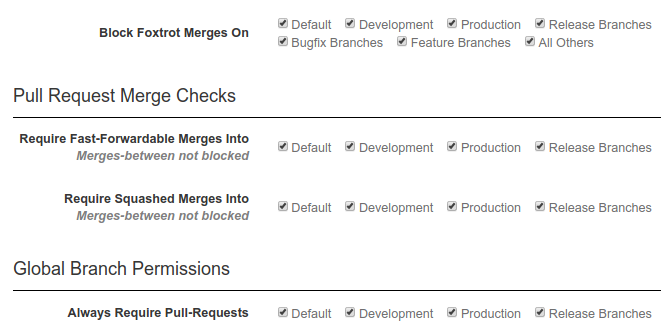

Exactly as @Mikael Sandberg mentioned: staff push to some random branch (e.g., "TKT-2345"), and Bitbucket is configured to allow that. But merging from TKT-2345 branch to master or release/* is only allowed via pull-request, which itself can require "minimum successful builds" (for the unit test) and "minimum approvals" (for the code review). Both of those settings are available under "merge checks" for a given repo or project (collection of repos).
The paid Control Freak add-on my company maintains is handy for globally enforcing a mandatory "must use pull-requests" policy for master and release/* in a single place, or you can use Bitbucket's own "Branch Permissions" feature.
Here's a screenshot from Control Freak:
