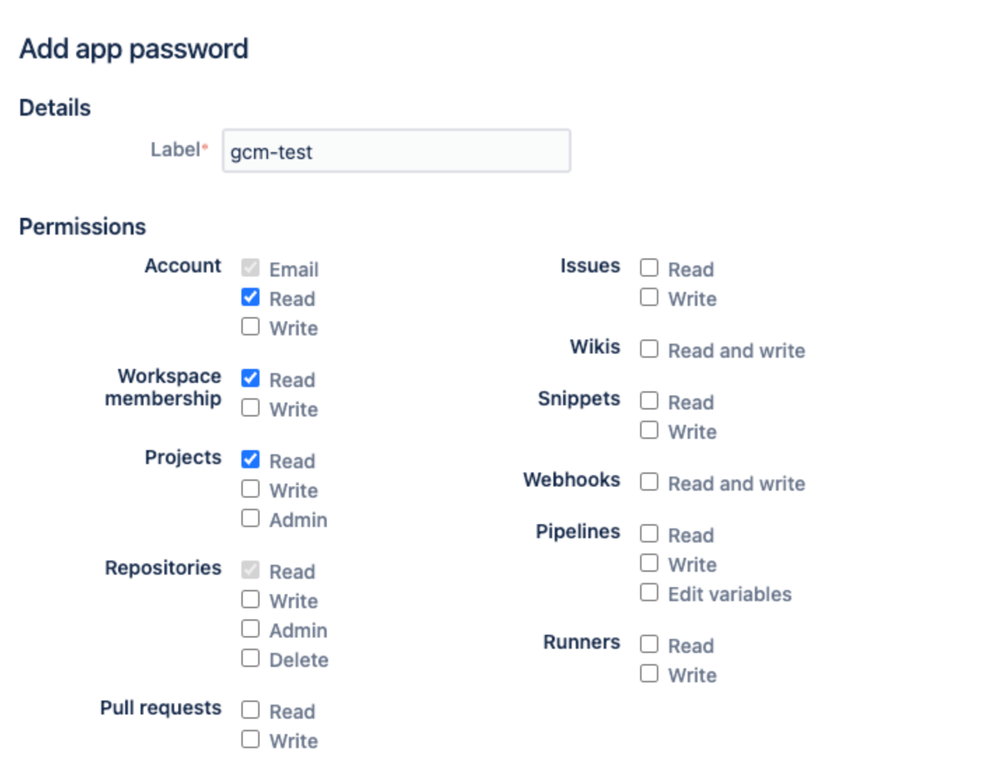

Also, it's important to note that according to GCM's documentation related to Bitbucket Authentication :
If you are planning to use an App Password for basic authentication, it must at a minimum have Account Read permissions (as shown below). If your App Password does not have these permissions, you will be re-prompted for credentials on every interaction with the server.
So could you please confirm if the app password you are using contains at least the scopes shown in the image?
