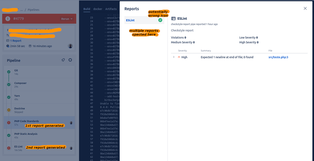

I'm facing the same issue: multiple steps running in parallel with fail-fast=false producing multiple checkstyle-reports via after-script hook, the Report Window (from PR or Pipeline result) shows only the later and only their comments are left on code.

Have a look at "CHECKSTYLE_REPORT_ID" field? It appears it needs to be different for each report according to the docs
https://bitbucket.org/atlassian/checkstyle-report/pull-requests/8#LREADME.mdF22T23
