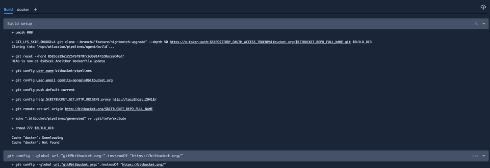

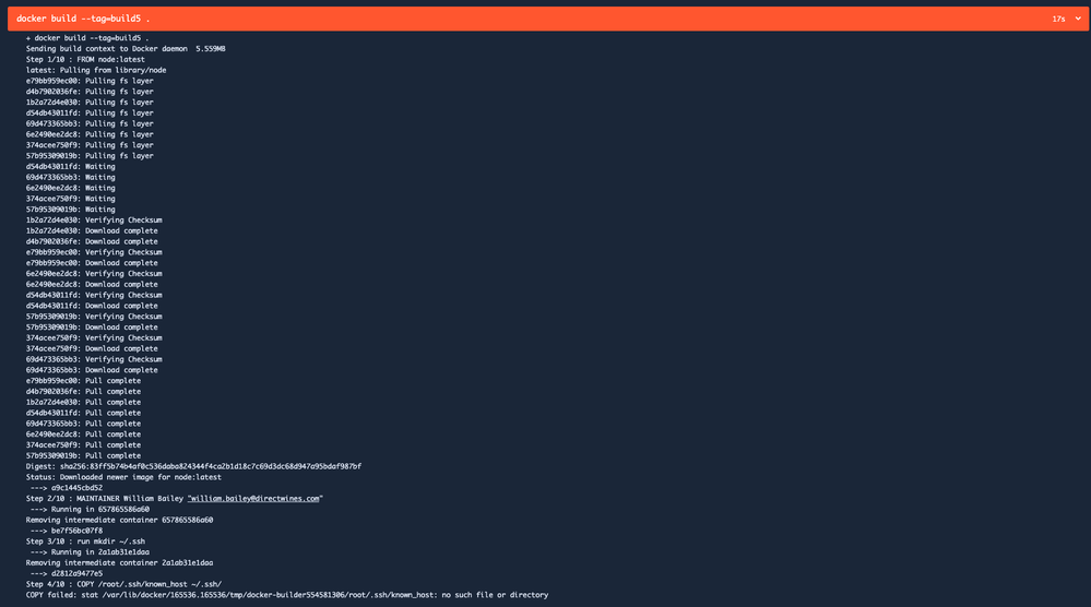

This is the result when running the pipeline.
Can you see anything obvious that may be causing it to still fail?
