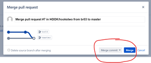

The thing is "preUpdate" is executed when clicking the merge button on the PR page.
At this stage - there is no selected strategy at all, because we select it on the merge dialog box which pops up afterwards:
Returning:
RepositoryHookResult.rejected('reason', 'description')
by the 'preUpdate' method cannot rely on the merge strategy simply because there is none selected at this point (it is 'Optional.Empty' at this point).
Maybe I'm using the wrong method? Is there a method which is executed once actually triggering the merge in the merge dialog box?
BR, Tal
'preUpdate' is used on 2 occasions:
1. When rendering the merge button (disabling it, if rejected)
2. When actually merging the PR, the merge fails if rejected by hook
You can make merge strategies available in repository or project settings.
If more than one is available the user can't merge, I don't know though if the merge popup modal button will be disabled, i.e. if the change in the selected value would trigger a merge-check in the back-end to validate the method.
Can you just configure merge-strategies that are allowed on project or repo level?
Here's another thought: Have you tried for the hook to _update_ the PR merge strategy to the correct one by modifying the pull request? I would confirm with the Atlassian bitbucket team though if that's possible.
Hi Ulrich - thanks again!
I got it to work!
My hook now accepts the first occasion ("When rendering the merge button"), by simply checking if the optional StrategyId is empty (it is empty because I didn't have the chance to set it yet.)
Now, the second occasion ("When actually merging the PR") is triggered when clicking the merge button on the modal popup. Here, a strategy is already selected and I can work with it to run the logic I'm aiming for and reject forbidden workflows.
"Can you just configure merge-strategies that are allowed on project or repo level?"
-No... as the header of the discussion says, I need to apply a per-branch logic.
Here's a screenshot (ignore the logic it implements, it's just a POC):
Thanks so much for your valuable and persistent help,
BR, Tal.
