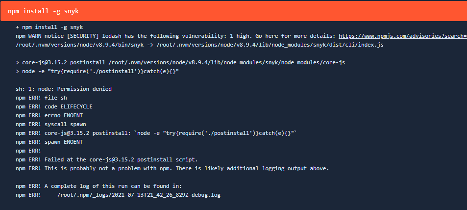

I'm trying to install and run snyk on a project. I'm facing the below issues
script:
npm install -g snyk # binary download also available
snyk test <<project>>
pipe: snyk/snyk-scan:0.5.1
variables:
SNYK_TOKEN: <<snyk token>>
Issue 1: When trying to install snyk using npm install -g snyk command I'm getting the below error

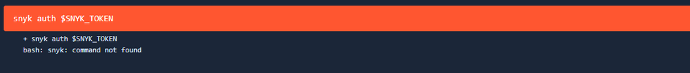

Issue: When I use the command npm install snyk , snyk is installed , but not recognised
Any help on solving this will be really helpful.

Sanju Ammu July 20, 2021
Issue is fixed by adding the below 2 lines of code.
- npm config set user 0
- npm config set unsafe-perm true
