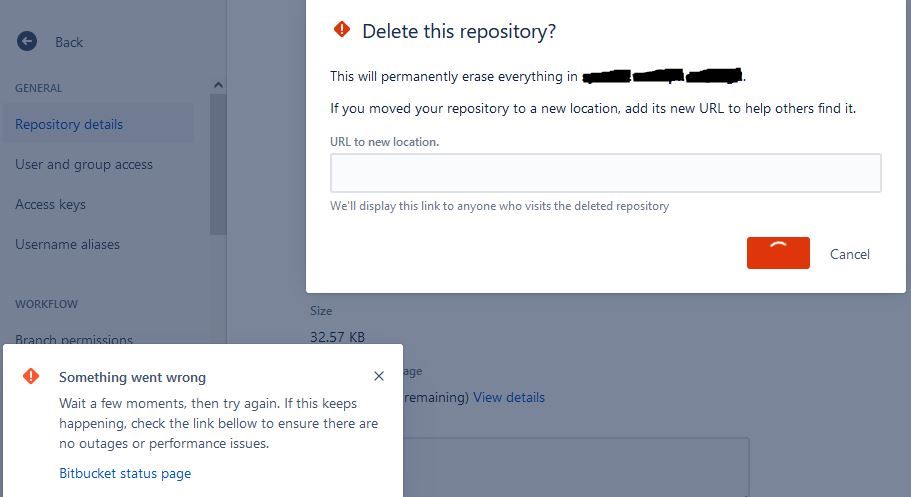

I am trying to delete a Bitbucket Cloud repository. I navigate through Repository settings -> Repository details -> Manage repository -> Delete repository -> Delete.
When I click on delete I get the below pop-up:
It's the same for last 1 day. When I checked with the Bitbucket Status Page, everything is operational.
Additional Info:
I am facing this issue in the repositories for which I had tried to rename the repository using REST API. For other repositories which I don't rename, I am able to delete it. I believe it's a bug from Bitbucket.

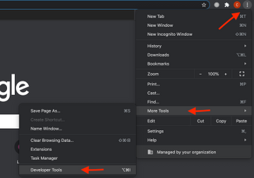

The “Something went wrong" message usually comes with a 5xx response that shows a Sentry ID code. This code may give us some indication of what is causing this issue. In this case, could you please follow the next steps to find the Sentry ID, so I can further investigate this case?
  • Open the "Developer tools" in the browser you are using (click on the three dots > More tools > Developer Tools):
  • Then navigate to the Bitbucket page that gives you this error (try to delete the repo)
  • In "Developer tools", select the Network tab
  • Find and select the request that gives a 5xx response
  • In the Headers panel (after you select the request with 5xx response), check if there is a field named sentry id.
If you can provide us with the value of that field, we can look it up in our system for further info.
