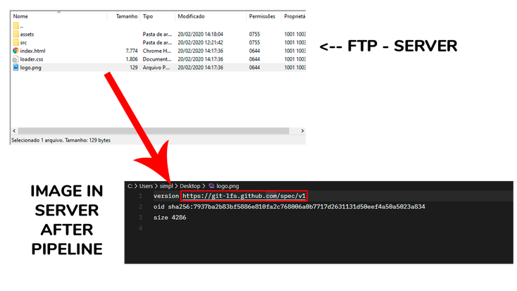

PROBLEM: Apparently the bitbucket pipelines does not yet have support for git LFS, we are trying to deploy to our homologation server, but the images are not being carried out the normal conversion at the time of the ftp transfer. Below is the code we use in the pipeline:

After a commit the above pipeline is executed, the output we have on our server with the LFS files from the repository is not as expected, following images below:

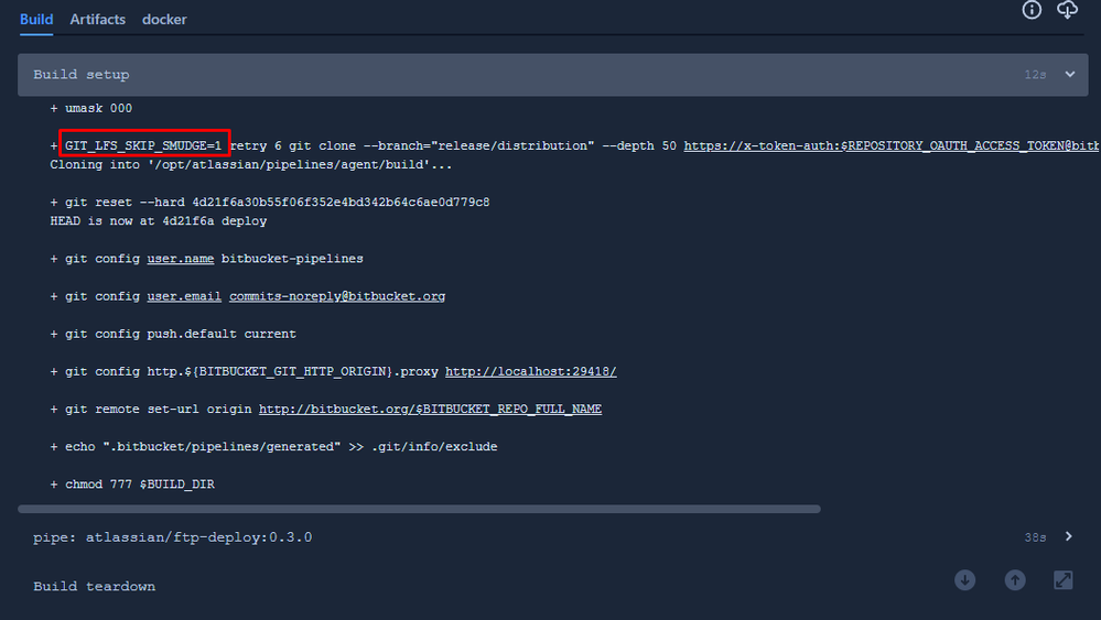

Problema_Pipelines_Montagem.png SOLUTION: After some research I was able to verify that the pipeline executes the following command (image below):
GIT_LFS_SKIP_SMUDGE=1 git clone won't fetch all binary files by default
Would it be possible to remove this parameter during the pipeline setup? Is this the real cause of the problem?

Hello @kaique_tavares ,
Thanks for reaching out.
It looks like you didn't specify a property to enable LFS, as described on this page:
clone:
lfs: true
There's also a blog post with little bit more details on how that works.
Hope this helps.
Cheers,
Daniil
Chris Smith February 20, 2020
I can confirm this works.  I have the same in my own bitbucket-pipelines.yml
