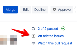

You can also find Jira issues related to a particular pull request:
We're working on surfacing the same information in the new PR experience, this should be available in the near future. Note that this only looks at the content of that particular PR, so is functionally different from what Deployments do.
