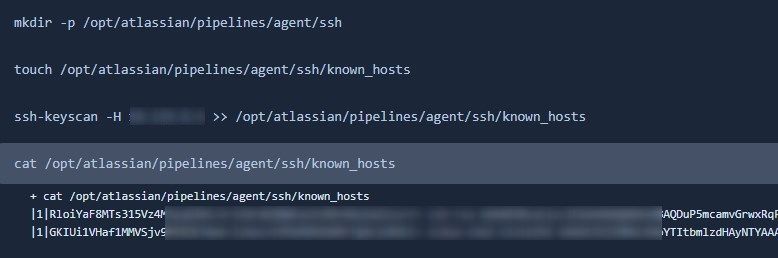

I've been trying to update /opt/atlassian/pipelines/agent/ssh/known_hosts on different ways but always end with same result : Host key verification failed.
As you can see in the picture, i'm able to update known_hosts file but bitbucket seems to not use it.
