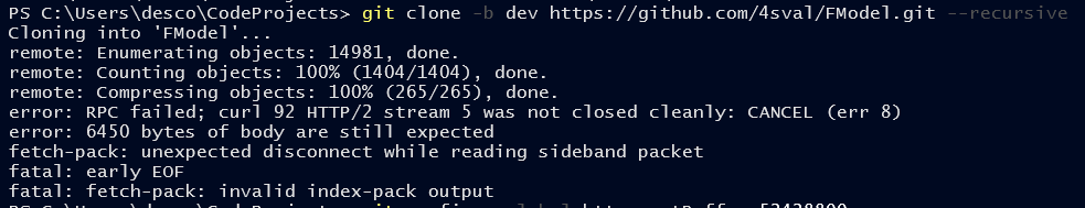

It doesn't always fix it, it seems. I've never had this error before, but it happened when trying to clone a Github repo (that I've never tried before) by Github Desktop as well as by git clone the URL, and now again while trying the "fix".
git config --global http.postBuffer 52428800
git config --global core.compression 0
cd /Volumes/WD_Elements2018/GitHub/
git clone https://github.com/eliranwong/UniqueBible.git --depth 1
Cloning into 'UniqueBible'...
remote: Enumerating objects: 187613, done.
remote: Counting objects: 100% (187613/187613), done.
remote: Compressing objects: 100% (186984/186984), done.
error: RPC failed; curl 92 HTTP/2 stream 5 was not closed cleanly: CANCEL (err 8)
error: 1378 bytes of body are still expected
fetch-pack: unexpected disconnect while reading sideband packet
fatal: early EOF
fatal: fetch-pack: invalid index-pack output
