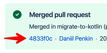

For a merged pull request you should be able to see the merge commit hash in the UI:

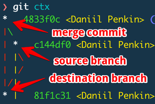

Now, that merge commit has two parents: first one is the tip of the PR target branch just before merging, and the second one is the tip of the PR source branch at the same time.
What you can do is first checkout the merge commit and then reset to the second parent – this way you'll end up on the tip of the source branch of the PR. In my case it would be this:
git checkout 4833f0c
git reset HEAD^2
In my example this will bring me to c144df0. If I understand correctly, this is what you're trying to achieve.
