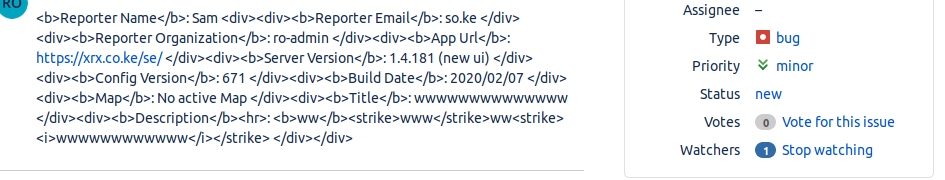

for my case, it works too for the raw and the comment is saved ok. My problem is with html content. How do you do it, because the structure given by the documentation doesn't work. Tried something like
"content": {
"raw": "Just checking",
"markup": "markdown",
"html": "<h4>Just checking</h4>",
"type": "rendered"
As it is on the documentation, but doesn't work. This is very important for my case.
The result for my case is as shown in screenshot below, thanks
