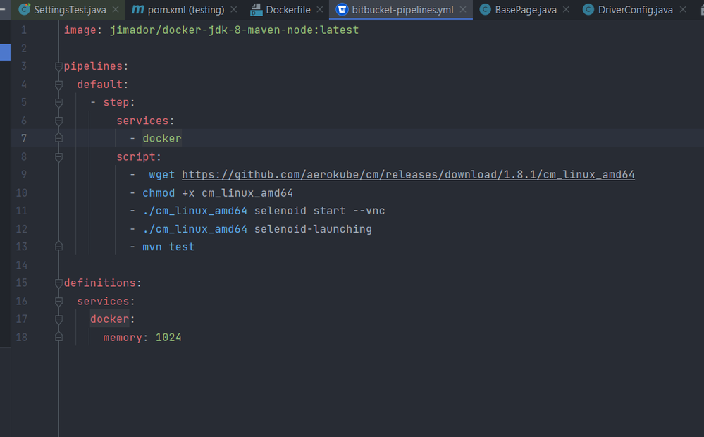

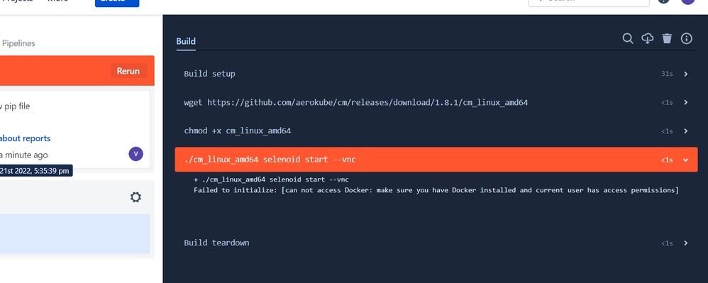

Hi!
I supplemented the script, but it didn't help. Not enough accesses(
Thank you for the picture, there was no Docker service initiated, that's why you had this problem.
I edited yesterday's comment with a docker service.
Can you try that and let me know if it works for you?

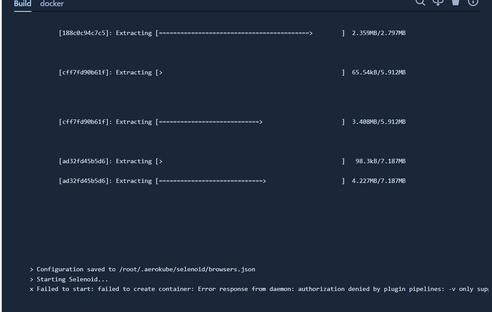

"x Failed to start: failed to create container: Error response from daemon: authorization denied by plugin pipelines: -v only supports $BITBUCKET_CLONE_DIR and its subdirectories"
Hi @Vitali Konachyk,
Please allow me to step in as Norbert is out of office.
Based on the error message, it looks that the command you are running may be trying to create a Docker container and mount volumes outside $BITBUCKET_CLONE_DIR ($BITBUCKET_CLONE_DIR is the path where your repo is cloned in the Docker container that runs your build).
If so, this is something that is not supported in Pipelines, see below the section "Full list of restricted commands":
I would suggest reaching out to the developers of selenoid (you can create an issue here: https://github.com/aerokube/selenoid/issues), ask what directory is being mounted, and if it is possible to change that e.g. with a configuration file in your repo.
Theodora
