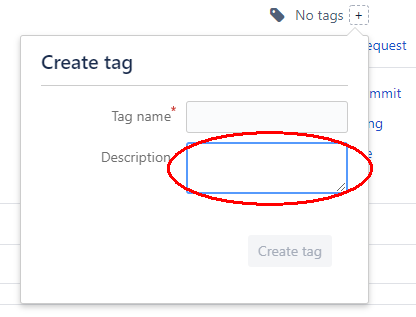

When tagging, BitBucket opens a field to add a description to the tag. Where can I view that description after creating the tag?

Looks like there's currently indeed no view in Bitbucket UI where you can see tag description after you created it. I'll follow up on this with the team: we might've changed some things around displaying commit metadata in a not very consistent manner.

Not sure if you mistakenly mentioned Bitbucket Server, but I indeed can't find tag messages in Server either. Create tag dialog is similar, i.e. it contains an input field for the tag description, but once created that message is not visible anywhere in UI.
