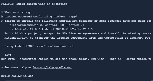

I am not able to run bitbucket pipeline getting 'Failed to install the following Android SDK packages as some licences have not been accepted' error.
Please find below a screenshot of the error.
your commands / dependencies need to run in non-interactive mode.
From what I see on your screenshot, your dependency could not be installed due to not accepting your license.
There should not be any user interaction required, no prompts asking the users for input or validation.
Hello Johan,
It was running perfectly a few days ago, I haven't done any changes in the dependencies. suddenly I got the above error on bitbucket while running pipeline.
