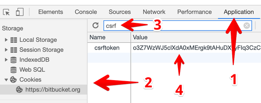

  3. We need to find the CSRF token to authenticate request. It is stored in a cookie called crftoken. In Chrome this is under Application tab, StorageCookies section in the sidebar (in Firefox the tab is called Storage, then Cookies in the sidebar). Note down the value, we'll need it in the next step.

  4. Now switch to the Console tab and paste the following code, replacing placeholders:
    fetch('/<account>/<repo_slug>/issue/spam/<issue_id>', {
    method: 'POST',
    headers: {
    'X-CSRFToken': '<CSRF token>'
    }).then(console.log)
    For instance, here's how it looks for my test issue from the screenshot above:
    fetch('/dpenkin/unspam/issue/spam/1', {
    method: 'POST',
    headers: {
    'X-CSRFToken': 'o3Z7Wz...'
  5. Hit Enter. You'll see a response with 410 status code, but in fact the issue is now not marked as spam. Note that if you run same request again, you'll mark it as spam again.
  6. Refresh the issue list or navigate to the issue in question. It should now be not marked as spam anymore. You might need to force refresh the page to see the changes.

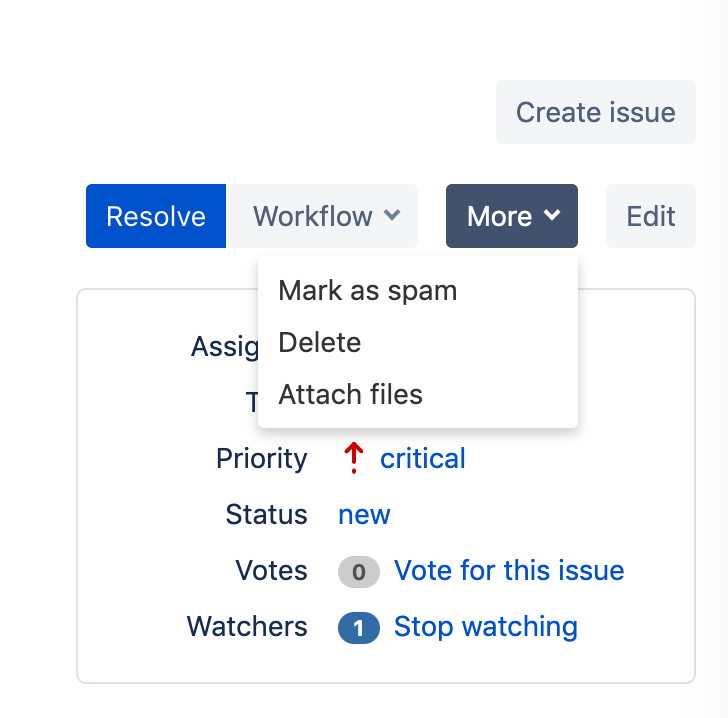

The issue tracker for Bitbucket does not have a "mark as spam" function.
Could you tell us what you marked as spam mistakenly?  If it is a community post, we can un-spam it, and if it is something else, we can find a moderator.
may-solty December 7, 2019
Thank you for replying.
Really? Then I may have a mistake in the question?
Can you see this? This is a capture on Bitbucket/Issues screen at top of right side.
Thank you.
