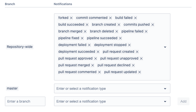

You can also set the chat notifications for your repository after you integrate bitbucket into a slack channel. This works great, and I get a pass/fail notice after every pipeline run in my slack channel.

But how to set this up especially for custom pipelines only (here: that have been triggered by the scheduler)? I didn't find that option and the original poster (OP) asked for that. Maybe you know more?
Open the repository
Open Repository Settings
Open Chat Notifications
- if you don't already have a subscription configured, then you need to do that first
Configure the notifications you want, like "pipeline failed"
@chare Yes that dialog, unfortunately there is no differentiation between the type of a pipeline possible, e.g. only failed custom pipelines.
I think it does work, it's just then it's for all failed Pipelines which might be too much for specific messaging.
