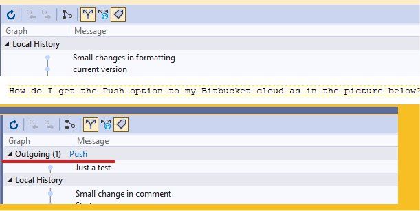

But now, when I click on the lower right git symbol with my project's name (this opens the Git Repository) I do not see a Push option (to get the changes to the Bitbucket cloud).
I can now choose Git/Push to Git service, then select Existing Remote, https://MyName@bitbucket.org/MyName/mysolution.git and push from there, but I have to do that every time again.
1 So what can I do to push changes to the bitbucket repo easily? It works in 1 solution, see lower picture and not in the other one, see upper picture.
2 What should I do differently in the above steps?
